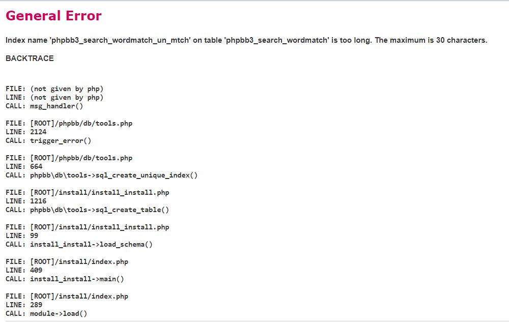

phpBB3.0.14版本時,我是資料表頭是phpbb3_,升級為phpBB3.1.0版本phpbb3_
我曾經重灌新的(此刻重新灌新),當我設定資料表頭為phpbb3_ 時
就有警告過我,就無法設定
就有警告過我,就無法設定
General Error
Index name 'phpbb3_search_wordmatch_un_mtch' on table 'phpbb3_search_wordmatch' is too long. The maximum is 30 characters.
BACKTRACE
FILE: (not given by php)
LINE: (not given by php)
CALL: msg_handler()
FILE: [ROOT]/phpbb/db/tools.php
LINE: 2124
CALL: trigger_error()
LINE: 664
CALL: phpbb\db\tools->sql_create_unique_index()
FILE: [ROOT]/install/install_install.php
LINE: 1216
CALL: phpbb\db\tools->sql_create_table()
LINE: 99
CALL: install_install->load_schema()
FILE: [ROOT]/install/index.php
LINE: 409
CALL: install_install->main()
LINE: 289
CALL: module->load()
