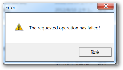

還有我找不到 php5ts.dll
重新啟動 Apache2.4發生錯誤,已經無法啟動
輸入 http://localhost/phpinfo.php
出現 :arrow: 瀏覽器無法連線至 localhost

新版本 Apache 啟動錯誤
error.log 好像沒動靜了
[Sat Aug 10 12:10:20.616148 2013] [mpm_winnt:notice] [pid 2604:tid 284] AH00418: Parent: Created child process 2948
[Sat Aug 10 12:10:21.521162 2013] [mpm_winnt:notice] [pid 2948:tid 172] AH00354: Child: Starting 64 worker threads.
[Sat Aug 10 12:47:44.103510 2013] [mpm_winnt:notice] [pid 2604:tid 284] AH00422: Parent: Received shutdown signal -- Shutting down the server.
[Sat Aug 10 12:47:46.131514 2013] [mpm_winnt:notice] [pid 2948:tid 172] AH00364: Child: All worker threads have exited.
[Sat Aug 10 12:47:46.147114 2013] [mpm_winnt:notice] [pid 2604:tid 284] AH00430: Parent: Child process 2948 exited successfully.
[Sat Aug 10 20:07:20.627398 2013] [mpm_winnt:notice] [pid 2620:tid 284] AH00455: Apache/2.4.4 (Win64) configured -- resuming normal operations
[Sat Aug 10 20:07:20.633648 2013] [mpm_winnt:notice] [pid 2620:tid 284] AH00456: Server built: Feb 22 2013 22:08:37
[Sat Aug 10 20:07:20.633648 2013] [core:notice] [pid 2620:tid 284] AH00094: Command line: 'C:\\Apache\\bin\\httpd.exe -d C:/Apache'
[Sat Aug 10 20:07:20.634898 2013] [mpm_winnt:notice] [pid 2620:tid 284] AH00418: Parent: Created child process 2928
[Sat Aug 10 20:07:21.244907 2013] [mpm_winnt:notice] [pid 2928:tid 172] AH00354: Child: Starting 64 worker threads.
[Sat Aug 10 23:50:15.362817 2013] [mpm_winnt:notice] [pid 2620:tid 284] AH00422: Parent: Received shutdown signal -- Shutting down the server.
[Sat Aug 10 23:50:17.390820 2013] [mpm_winnt:notice] [pid 2928:tid 172] AH00364: Child: All worker threads have exited.
[Sat Aug 10 23:50:17.406420 2013] [mpm_winnt:notice] [pid 2620:tid 284] AH00430: Parent: Child process 2928 exited successfully.
[Sun Aug 11 08:32:39.932172 2013] [mpm_winnt:notice] [pid 2540:tid 284] AH00455: Apache/2.4.4 (Win64) configured -- resuming normal operations
[Sun Aug 11 08:32:39.952172 2013] [mpm_winnt:notice] [pid 2540:tid 284] AH00456: Server built: Feb 22 2013 22:08:37
[Sun Aug 11 08:32:39.953422 2013] [core:notice] [pid 2540:tid 284] AH00094: Command line: 'C:\\Apache\\bin\\httpd.exe -d C:/Apache'
[Sun Aug 11 08:32:39.953422 2013] [mpm_winnt:notice] [pid 2540:tid 284] AH00418: Parent: Created child process 2940
[Sun Aug 11 08:32:40.465930 2013] [mpm_winnt:notice] [pid 2940:tid 172] AH00354: Child: Starting 64 worker threads.
[Sun Aug 11 09:10:09.500550 2013] [mpm_winnt:notice] [pid 2540:tid 284] AH00424: Parent: Received restart signal -- Restarting the server.
httpd.exe: Syntax error on line 526 of C:/Apache/conf/httpd.conf: Cannot load c:/php5/php5apache2_4.dll into server: \xa7\xe4\xa4\xa3\xa8\xec\xab\xfc\xa9w\xaa\xba\xbc\xd2\xb2\xd5\xa1C
[Sun Aug 11 09:10:11.503665 2013] [mpm_winnt:notice] [pid 2940:tid 172] AH00364: Child: All worker threads have exited.
